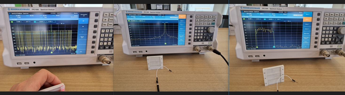

Kann man als Funkmodul die einfachen 3-Pin 433MHz Teile verwenden?
https://www.ebay.de/itm/395115399859

Hello Christian.
My first thought was, the modulation is FM. But reading the topic, I see
ASK is being used.
The measurements are already some time ago, no notes on this. Next week
I will check my current Gira transmitters with a decent
spectrum-analyser. If it's AM, then it is worth a try.

Checked the transmitter I have. (See picture)
what is unexpected is the center frequency, it is 433.4MHz. A popular
value but not the by Gira advertised frequency of 433,24MHz.
The instrument is not really a great radio receiver but it is very
likely the transmitter is ASK. FM demodulation gives hardly any signal.
Tracing the amplitude in time fits perfectly with the telegrams send on
the FunkBus.
So using a transmitter like https://www.ebay.de/itm/395115399859 should
be possible. I like to try this and will order a few of those.
However keep in mind, to be a kind of legal and responsible, never
occupy the 433MHz band averagely more than 1% (In a timespan of, I think
10 seconds). Also don't exceed 10mW output power.
To be continued...
