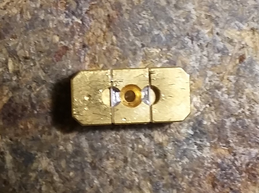

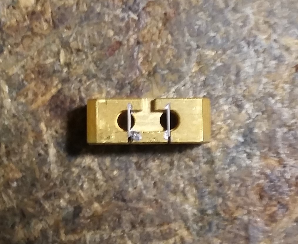

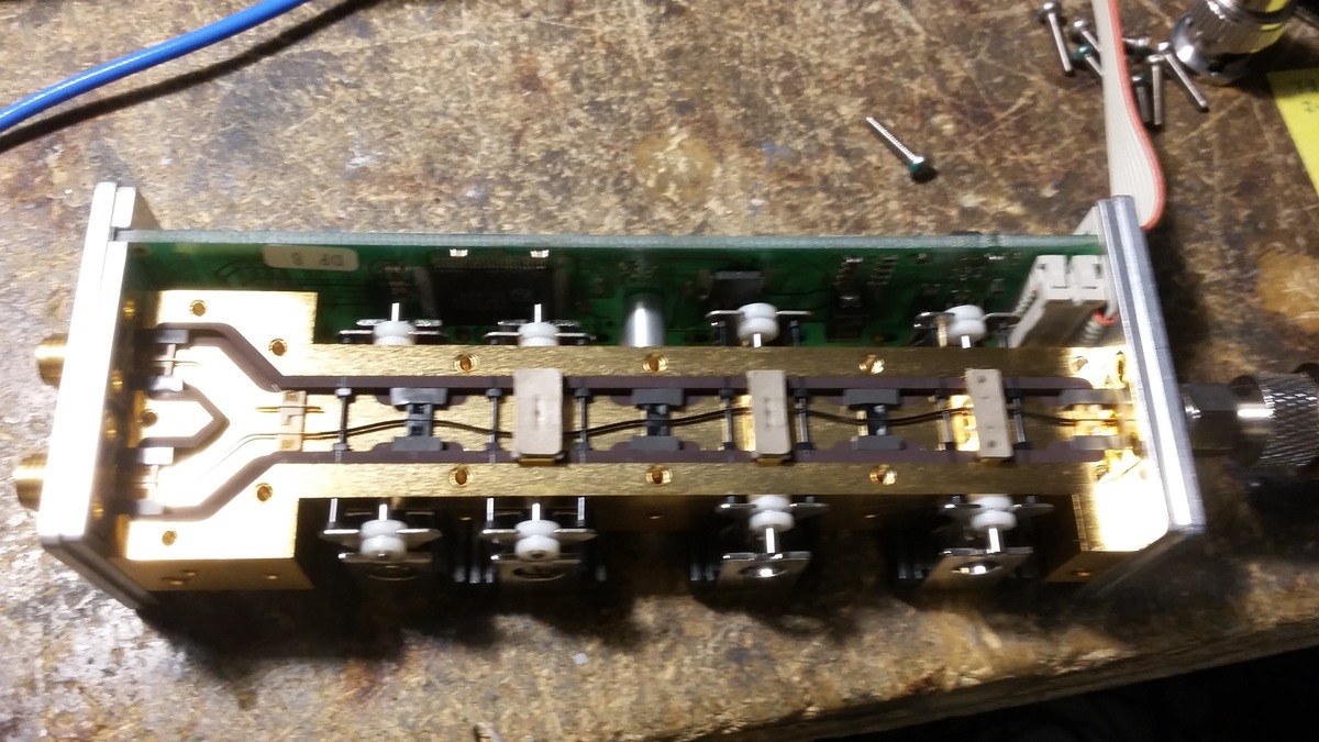

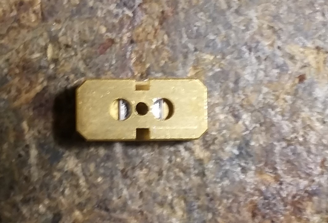

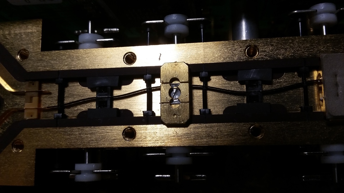

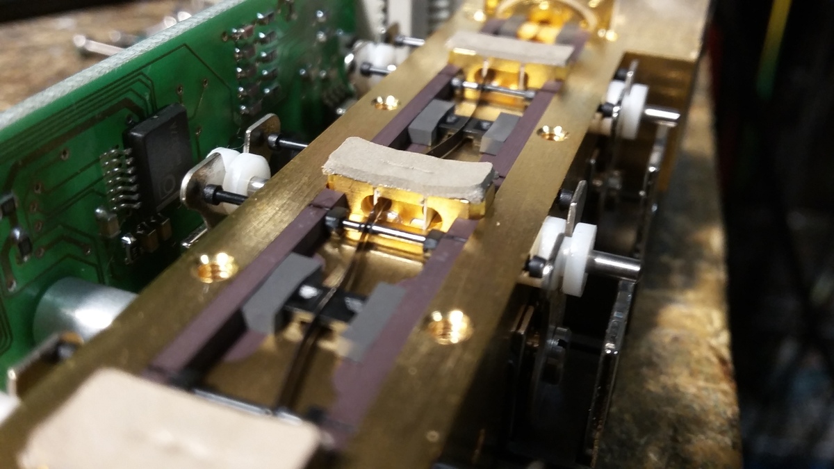

I purchased an R&S FSP-30 on Ebay which had a defective system disk.
After replacing the disk and rebuilding the system firmware, I saw that
the step attenuator is also defective. After determining that all 3
attenuator pads were burned out (measuring ca.400k, 8.2M and 530k for
the 10, 20 and 40 dB pads respectively) I decided to take the step
attenuator apart and attempt repairing it. The pads are soldered into
removable brass fixtures. I am trying to source the individual pads to
be able to attempt replacing them.
The fixtures measure ca 10.7mm x 5.1mm x 4.9mm and the pads measure ca.
5mm x  2.5mm.  Has anyone already attempted repair of this step
attenuator and/or have any references for sourcing either the pads alone
or fixtures with pre-mounted pads?
Thanks for any help.

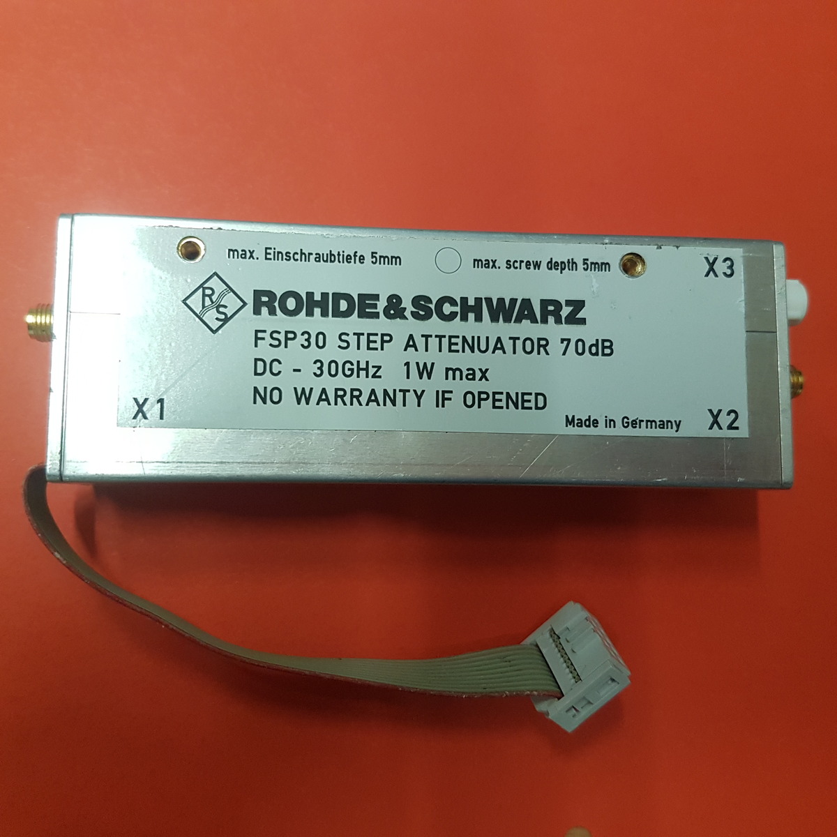

von Gerhard P. (1123gp)
Hallo, ich habe zwar keinen R&S FSP30, wohl aber den zugehörigen Step
ATTENUATOR (Bild als ANLAGE); für ein vernüftiges Angebot bin ich bereit
den abzugeben.  Gruß Gerd
von Mobile (mobileteser)
If the attenuator is fully burned, mostly the first mixer is also dead.
Before you change the attenuator, check the LO Level at 0 Hz. This will
give you an indication if the first mixer is working. Maybe a internal
test is partly working.

von Vincent (attenuator)
Hallo, I have an R&S FSP30, as well as the corresponding step
attenuators (see attached picture); to provide a reasonable quotation, I
am willing to sell them. Sincerely, Vincent
