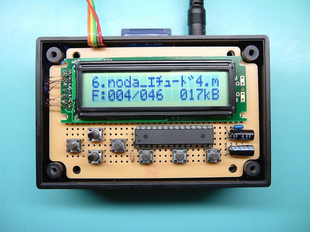

Hallo, Ich machte einen japanischen homepage. http://akiba.geocities.jp/atmel_avr_atros/j_mrmidi2.html Eine Lücke wird von LCD gezeigt, wenn ich Charakterschnur für (0xA0-0xDF) einen Aktennamen benutze. Ich will Charakterschnur (0xA0-0xDF) zeigen. Welchen Teil sollte ich bestätigen? LCD-ANZEIGE-DATENBLATT http://www.sunlikedisplay.com/data/t13.pdf
すごい。 MrMidi2 goes Japan :-) Please post in English (instead of using a computer as translator, which produces unreadable garbage, most Germans can read and write English quite well) - but from your posting I understood that you want to display the japanese charset of your LCD. If you use long file name entries, it should work (but MrMidi can't read unicode, it interprets only the lower char byte). You can attach a sample rootdir sektor from your SD card where you stored japanese file names (extracted using a disk editor) and I will look into it! I attached the binaries of a new Ultimate tryout-version, too. The sources will be available soon, too. Have fun! And: I like your page! Simon
こんにちは! I am not good at the English....(^_^; I tested Tryout version. The result was not displayed. I examined it. The katakana seems to be expressed in UTF-16. http://www.unicode.org/charts/PDF/UFF00.pdf >And: I like your page! Thank you!
This is my analysis: - I named a file "ごめんなさい.mid" - MrMidi displays "T jUD.mid" - I read the root dir long file name entry on the card using disk editor: 41 54 30 81 30 39 30 6A 30 55 30 0F 00 EC 44 30 2E 00 6D 00 69 00 64 00 00 00 00 00 FF FF FF FF - LFN starts at offset 1 - MrMidi interprets all lower bytes of unicode as ASCII :-) I will implement a japanese char mapper for the kana (unicode high byte 0x30) when I get the time!
It will require a lookup-table to map 0x30xx unicode (my Windows uses these) to LCD chars. The 0xFFxx charset is now implemented (a simple add 0x40) - try it out!
Here is the proof - I just extracted the midi file in midi.zip onto my card. Windows shows me some crap instead.
Thank you for Simon ! It is good! It was displayed katakana! Japanese fans increase! A European version or the Russian version are possible, too A screen is wide! 27x4 LCD?? not sold in Japan... orz (I'm sorry in funny English.)

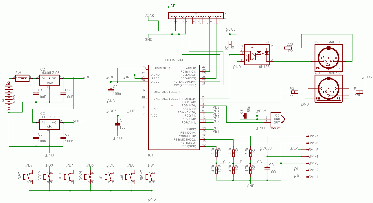

Hallo zusammen, für den Mr.Midi2 gibt es ja einen Schaltplan. Hat schon jemand eine Layout (brd) für den Mr. Midi erstellt? Am besten mit Eagle. Danke

Hi Thomas, kannst Du die Brd-Datei einstellen? Gruss Joachim
