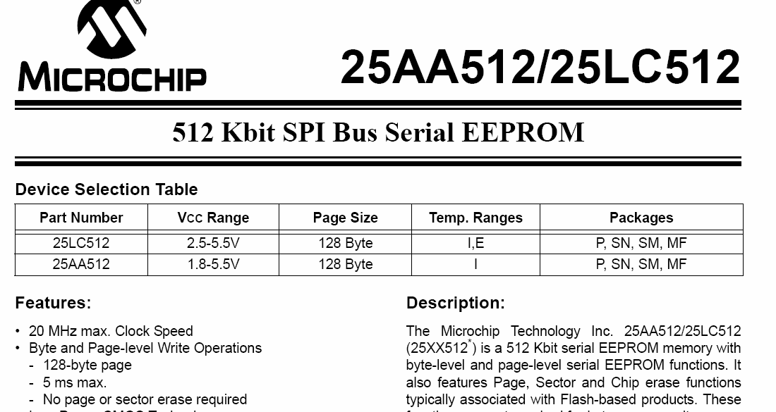

Habe noch ne Frage zur EEProm Sruktur: Kann ich bei einem 512kByte EEprom auf 512*1024 Byte Adressen zugreifen? Hier ein Programm aus dem Forum: Warum weist er dem Zeiger einen Wert von 2 zu? Hat das damit zu tun dass er 65534 Bits hat? (8kByte EEPROM) mfg [c] //eeprom instructions #define WREN 0x06 #define WRDI 0x04 #define RDSR 0x05 #define WRSR 0x01 #define READ 0x03 #define WRITE 0x02 void spi_init(void); //initialize spi interface unsigned char spi_transfer(unsigned char data); //transmit data via spi void spi_eeprom_write(unsigned int adress, unsigned int data); //write data to external eeprom via spi unsigned int spi_eeprom_read(unsigned int adress); //read data from external eeprom via spi int main(void) { //init ports DDRB = 0xFF; PORTB = 0xFF; DDRC = 0x00; PORTC = 0x00; DDRC = 0xFF; PORTC = 0x00; spi_init(); spi_eeprom_write(0,1); unsigned int data = spi_eeprom_read(0); for(;;); } void spi_eeprom_write(unsigned int adress, unsigned int data) { adress *= 2; unsigned char dummy; if (adress < 65534) { PORTB &= ~(1<<CS); //pull chip select low dummy = spi_transfer(WREN); //transmit write enable instruction PORTB |= (1<<CS); //pull chip select high _delay_ms(1); PORTB &= ~(1<<CS); //pull chip select low dummy = spi_transfer(WRITE); //transmit write instruction dummy = spi_transfer((unsigned char) adress>>8); //transmit adress MSB dummy = spi_transfer((unsigned char) adress); //transmit adress LSB dummy = spi_transfer((unsigned char) data>>8); //transmit data MSB dummy = spi_transfer((unsigned char) data); //transmit data LSB dummy = spi_transfer(WRDI); //transmit write disable instruction PORTB |= (1<<CS); //pull chip select high } } //end of eeprom_write unsigned int spi_eeprom_read(unsigned int adress) { unsigned char dummy; unsigned int data = 0; PORTB &= ~(1<<CS); //pull chip select low dummy = spi_transfer(READ); //transmit write enable instruction dummy = spi_transfer((unsigned char) adress>>8); //transmit adress MSB dummy = spi_transfer((unsigned char) adress); //transmit adress LSB data += (8<<spi_transfer(0x00)); //read data LSB by dummy transmission data += spi_transfer(0x00); //read data MSB by dummy transmission PORTB |= (1<<CS); //pull chip select high return data; } //end of spi_eeprom_read void spi_init(void) { DDRB |= (1<<PB3) | (1<<PB5); //set MOSI and SCK output DDRB &= ~(1<<PB4); //set MISO input SPCR = (1<<SPE) | (1<<MSTR); //enable spi, master, clock rate f_cpu/4 } //end of spi_init unsigned char spi_transfer(unsigned char data) { SPDR = (unsigned char) data; //transmit data while (!(SPSR & (1<<SPIF))); //wait for transmission complete return SPDR; [\c]
es sind Seiten von 256 Byte. Der Counter ist selbst incrementierend und macht nach FF Roll over. Also dann neue Adresse setzen. Keine Ahnung was er mit 2us macht. Beim Lesen gibt es keine Zeiten in diesem Bereich. Beim Schreiben pro Page oder Byte eben 4-5 ms
Mir stehen bei 512kByte 524288 Byte zu verfügung. Kann ich direkt auf Adresse 5242.. zugreifen (schreiben,lesen)?
Hast Du das Datenblatt immer noch nicht gelesen? 25AA512 ist ein 512 KBit-EEPROM, das heißt 56536 Bytes.
hab mich vertan. Kann man jetzt auf die Adressen durchgehend zugreifen oder nicht? mfg

Ja, kann man. Beim seitenweisen lesen sollte man aber den Zeiger immer auf den Anfang einer Seite setzen (also in diesem Fall auf ein Vielfaches von 128), da es sonst passieren kann das er dir Daten von zwei Seiten mischt, da serielle EPROMS immer nur den internen Zähler für die einzelnen Bytes innerhalb der Seite hochzählt nicht aber den Zähler für die Seite. Wenn du also den Adresszeiger auf Byte 64 von Seite 0 setzt und du die nächsten 128 Bytes lesen willst (was also 64 Bytes von Seite0 und 64 Bytes von Seite1 wären), wird er dir dir hinteren 64 Bytes von Seite0 und dannach die vorderen 64 Bytes von Seite0 zurück geben, da er den Seitenzähler nicht automatisch erhöht. Einzelne Bytes können aber direkt Adressiert werden und kommen auch richtig zurück. Du kannst auch nur 4 oder 8 Bytes holen, musst aber auch hier auf die Seitengrenzen achten (es geht also nicht von Adresse 124, 8 Bytes zu lesen, da hier wieder ein Seitenwechsel statt findet). Sven
@Sven Stefan Gute erklärt! Jetzt bin ich schlauer geworden. Funtktioniert Byteweises schreiben mit den gleichen Bedinungen die du erwähnt hast?
NEIN. Wenn das EEPROM in Pages organisiert ist, muß immer eine gesamte Page geschrieben werden, auch wenn man nur ein einziges Bit eines Bytes innerhalb dieser Page geändert haben will. Die Struktur der Befehle und die genaue Abfolge der Steuersignale und das Timing entnimmst Du vielleicht dann doch dem Datenblatt.
@Travel Rec. (travelrec) >NEIN. Wenn das EEPROM in Pages organisiert ist, muß immer eine gesamte >Page geschrieben werden, auch wenn man nur ein einziges Bit eines Bytes >innerhalb dieser Page geändert haben will. Stimmt nicht. Wir reden über EEPROM, nicht FLASH! Siehe Speicher MFG Falk
Die üblichen EEPROMs besitzen alle solche Pages. Anders als bei Flash-ROMs kann man die Daten trotzdem byteweise schreiben. Man kann die Pages benutzen um Zeit zu sparen - man muss es aber nicht.
Zitat aus dem Datahseet Seite 8 "Up to 128 bytes of data can be sent to the device before a write cycle is necessary. The"
allerdings: "When doing a write of less than 128 bytes the data in the rest of the page is refreshed along with the data bytes being written." Er macht es also selber intern.

Und hier der Link zum Datenblatt des 25AA512 (32 Seiten / 476kB): http://www.datasheetarchive.com/pdf/4012139.pdf
