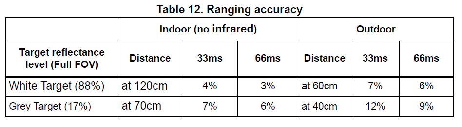

U. M. schrieb: > Laserentfernungsmessung ist wahrscheinlich die eleganteste Methode, nur > glaube ich nicht, dass du so was für 10€ als fertiges Modul kaufen > kannst. https://www.aliexpress.com/item/VL53L0X-Time-of-Flight-ToF-Laser-Ranging-Sensor-Breakout-940nm-GY-VL53L0XV2-Laser-Distance-Module-I2C/32773306734.html?ws_ab_test=searchweb0_0,searchweb201602_3_10000560_10000606_10000561_10000073_10000074_10000608_10000709_10000660_10000704_10000703_10000175_10000509_10000507_10000505_10000558_10136_10000068_10000552_10000369_10000063_10000365_10000367_10099_10000663_10000665_10096_10000669_10000569_10000097_10000094_10000337_10000723_10000090_10000147_10000091_10000726_10000144_10000339_10000729_10000150_10000679_10084_10000678_10083_10000676_10080_10000153_10000673_10082_10081_10110_10111_10112_10113_10000535_10114_10000534_10000089_10000086_10000710_10000083_10000349_10000690_10000135_10000716_10000080_10000693_10078_10000717_10079_10000688_10073_10000684_10000140_10070_10122_10123_10126_10124_10000546_10065_10068_10501_10000746_10000782_10000743_10000132_10000033_10503_10000786_10000030_10000026_10000126_10000023_10000129_433_10000123_10000696_10060_10062_10000699_10056_10055_10054_10000632_302_10059_10000738_10000120_10000774_10000734_10000020_10000778_10000013_10000117_10103_10102_10000016_10101_10000114_10000111_10052_10053_10107_10050_10106_10051_20517_10000621_10000384_20515_10000763_10000629_10000766_10000101_10000100_10000576_10000770_10000579_10000104_10000045_10000578_10000375_10000108_10000377_10000758_10000612_10000390_10000613_10000042_10000750_10000592_10000754_10000594_10000039_10000587_10000036_10000389_10000187-10051_10503_10501_20517_20515,searchweb201603_1,afswitch_1,ppcSwitch_5,single_sort_0_default&btsid=505145f1-9c4b-4e42-8f8d-d98ba6017d0d&algo_expid=0fc7a72d-977a-462a-8e96-216be8a3503e-5&algo_pvid=0fc7a72d-977a-462a-8e96-216be8a3503e > The VL53L0X from ST Microelectronics is a time-of-flight ranging > system integrated into a compact module. This board is a carrier > for the VL53L0X, so we recommend careful reading of the VL53L0X > datasheet (1MB pdf) before using this product. Keine Ahnung, wie gut das Teil ist. MfG Klaus

Klaus schrieb: > Keine Ahnung, wie gut das Teil ist. Was verstehst du an den Angabe im Kapitel 5.3 Ranging accuracy im Datenblatt des VL53L0X oder in der Beschreibung von Adafruit nicht? https://cdn-learn.adafruit.com/downloads/pdf/adafruit-vl53l0x-micro-lidar-distance-sensor-breakout.pdf Von Millimeter-Genauigkeit ist der Sensor weit entfernt.
