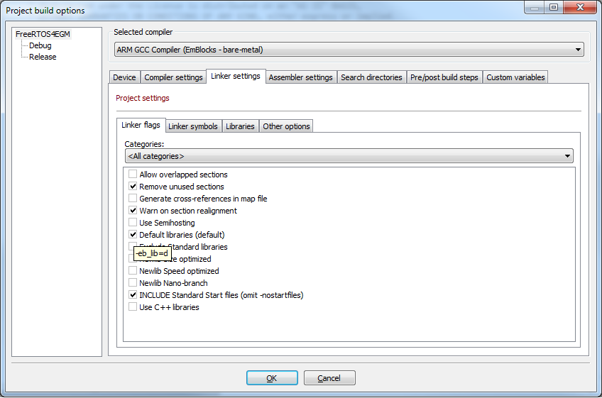

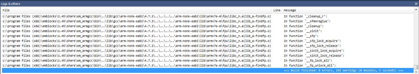

Wenn ich die Zeile "obj/rm_tcp.o(.bss .bss* COMMON)" zur bss_iram1 hinzufüge funktioniert nichts mehr. Der Compiler wirft folgendes:
1 | Linking executable: bin\Debug\FreeRTOS4EGM.elf |
2 | c:/program files (x86)/emblocks/1.45/share/em_armgcc/bin/../lib/gcc/arm-none-eabi/4.7.3/../../../../arm-none-eabi/lib/armv7e-m/fpu\libc_n.a(lib_a-findfp.o): In function `_cleanup_r': |
3 | findfp.c:(.text._cleanup_r+0x0): multiple definition of `_cleanup_r' |
4 | c:/program files (x86)/emblocks/1.45/share/em_armgcc/bin/../lib/gcc/arm-none-eabi/4.7.3/../../../../arm-none-eabi/lib/armv7e-m/fpu\libc.a(lib_a-findfp.o):findfp.c:(.text._cleanup_r+0x0): first defined here |
5 | c:/program files (x86)/emblocks/1.45/share/em_armgcc/bin/../lib/gcc/arm-none-eabi/4.7.3/../../../../arm-none-eabi/lib/armv7e-m/fpu\libc_n.a(lib_a-findfp.o): In function `__sfmoreglue': |
6 | findfp.c:(.text.__sfmoreglue+0x0): multiple definition of `__sfmoreglue' |
7 | c:/program files (x86)/emblocks/1.45/share/em_armgcc/bin/../lib/gcc/arm-none-eabi/4.7.3/../../../../arm-none-eabi/lib/armv7e-m/fpu\libc.a(lib_a-findfp.o):findfp.c:(.text.__sfmoreglue+0x0): first defined here |
8 | c:/program files (x86)/emblocks/1.45/share/em_armgcc/bin/../lib/gcc/arm-none-eabi/4.7.3/../../../../arm-none-eabi/lib/armv7e-m/fpu\libc_n.a(lib_a-findfp.o): In function `_cleanup': |
9 | findfp.c:(.text._cleanup+0x0): multiple definition of `_cleanup' |
10 | c:/program files (x86)/emblocks/1.45/share/em_armgcc/bin/../lib/gcc/arm-none-eabi/4.7.3/../../../../arm-none-eabi/lib/armv7e-m/fpu\libc.a(lib_a-findfp.o):findfp.c:(.text._cleanup+0x0): first defined here |
11 | c:/program files (x86)/emblocks/1.45/share/em_armgcc/bin/../lib/gcc/arm-none-eabi/4.7.3/../../../../arm-none-eabi/lib/armv7e-m/fpu\libc_n.a(lib_a-findfp.o): In function `__sinit': |
12 | findfp.c:(.text.__sinit+0x0): multiple definition of `__sinit' |
13 | c:/program files (x86)/emblocks/1.45/share/em_armgcc/bin/../lib/gcc/arm-none-eabi/4.7.3/../../../../arm-none-eabi/lib/armv7e-m/fpu\libc.a(lib_a-findfp.o):findfp.c:(.text.__sinit+0x0): first defined here |
14 | c:/program files (x86)/emblocks/1.45/share/em_armgcc/bin/../lib/gcc/arm-none-eabi/4.7.3/../../../../arm-none-eabi/lib/armv7e-m/fpu\libc_n.a(lib_a-findfp.o): In function `__sfp': |
15 | findfp.c:(.text.__sfp+0x0): multiple definition of `__sfp' |
16 | c:/program files (x86)/emblocks/1.45/share/em_armgcc/bin/../lib/gcc/arm-none-eabi/4.7.3/../../../../arm-none-eabi/lib/armv7e-m/fpu\libc.a(lib_a-findfp.o):findfp.c:(.text.__sfp+0x0): first defined here |
17 | c:/program files (x86)/emblocks/1.45/share/em_armgcc/bin/../lib/gcc/arm-none-eabi/4.7.3/../../../../arm-none-eabi/lib/armv7e-m/fpu\libc_n.a(lib_a-findfp.o): In function `__sfp_lock_acquire': |
18 | findfp.c:(.text.__sfp_lock_acquire+0x0): multiple definition of `__sfp_lock_acquire' |
19 | c:/program files (x86)/emblocks/1.45/share/em_armgcc/bin/../lib/gcc/arm-none-eabi/4.7.3/../../../../arm-none-eabi/lib/armv7e-m/fpu\libc.a(lib_a-findfp.o):findfp.c:(.text.__sfp_lock_acquire+0x0): first defined here |
20 | c:/program files (x86)/emblocks/1.45/share/em_armgcc/bin/../lib/gcc/arm-none-eabi/4.7.3/../../../../arm-none-eabi/lib/armv7e-m/fpu\libc_n.a(lib_a-findfp.o): In function `__sfp_lock_release': |
21 | findfp.c:(.text.__sfp_lock_release+0x0): multiple definition of `__sfp_lock_release' |
22 | c:/program files (x86)/emblocks/1.45/share/em_armgcc/bin/../lib/gcc/arm-none-eabi/4.7.3/../../../../arm-none-eabi/lib/armv7e-m/fpu\libc.a(lib_a-findfp.o):findfp.c:(.text.__sfp_lock_release+0x0): first defined here |
23 | c:/program files (x86)/emblocks/1.45/share/em_armgcc/bin/../lib/gcc/arm-none-eabi/4.7.3/../../../../arm-none-eabi/lib/armv7e-m/fpu\libc_n.a(lib_a-findfp.o): In function `__sinit_lock_acquire': |
24 | findfp.c:(.text.__sinit_lock_acquire+0x0): multiple definition of `__sinit_lock_acquire' |
25 | c:/program files (x86)/emblocks/1.45/share/em_armgcc/bin/../lib/gcc/arm-none-eabi/4.7.3/../../../../arm-none-eabi/lib/armv7e-m/fpu\libc.a(lib_a-findfp.o):findfp.c:(.text.__sinit_lock_acquire+0x0): first defined here |
26 | c:/program files (x86)/emblocks/1.45/share/em_armgcc/bin/../lib/gcc/arm-none-eabi/4.7.3/../../../../arm-none-eabi/lib/armv7e-m/fpu\libc_n.a(lib_a-findfp.o): In function `__sinit_lock_release': |
27 | findfp.c:(.text.__sinit_lock_release+0x0): multiple definition of `__sinit_lock_release' |
28 | c:/program files (x86)/emblocks/1.45/share/em_armgcc/bin/../lib/gcc/arm-none-eabi/4.7.3/../../../../arm-none-eabi/lib/armv7e-m/fpu\libc.a(lib_a-findfp.o):findfp.c:(.text.__sinit_lock_release+0x0): first defined here |
29 | c:/program files (x86)/emblocks/1.45/share/em_armgcc/bin/../lib/gcc/arm-none-eabi/4.7.3/../../../../arm-none-eabi/lib/armv7e-m/fpu\libc_n.a(lib_a-findfp.o): In function `__fp_lock_all': |
30 | findfp.c:(.text.__fp_lock_all+0x0): multiple definition of `__fp_lock_all' |
31 | c:/program files (x86)/emblocks/1.45/share/em_armgcc/bin/../lib/gcc/arm-none-eabi/4.7.3/../../../../arm-none-eabi/lib/armv7e-m/fpu\libc.a(lib_a-findfp.o):findfp.c:(.text.__fp_lock_all+0x0): first defined here |
32 | c:/program files (x86)/emblocks/1.45/share/em_armgcc/bin/../lib/gcc/arm-none-eabi/4.7.3/../../../../arm-none-eabi/lib/armv7e-m/fpu\libc_n.a(lib_a-findfp.o): In function `__fp_unlock_all': |
33 | findfp.c:(.text.__fp_unlock_all+0x0): multiple definition of `__fp_unlock_all' |
34 | c:/program files (x86)/emblocks/1.45/share/em_armgcc/bin/../lib/gcc/arm-none-eabi/4.7.3/../../../../arm-none-eabi/lib/armv7e-m/fpu\libc.a(lib_a-findfp.o):findfp.c:(.text.__fp_unlock_all+0x0): first defined here |
35 | collect2.exe: error: ld returned 1 exit status |
36 | Process terminated with status 1 (0 minutes, 5 seconds) |
37 | 0 errors, 165 warnings (0 minutes, 5 seconds) |
Siehe auch angehängtes Bild. Im Bild sieht man auch das der Build mit 0 Errors abgeschlossen wurde, aber ich kann den Code nicht Debuggen/ins Target laden. Viele Grüße crozeg
Das sieht mir jetzt so aus, als ob das mit dem Linkerscript nichts zu tun hätte - Du scheinst zu versuchen, die Newlib doppelt zuzulinken. Laß' mal deinen Linker-Aufruf sehen.

Hallo, seit ich in den Em::Blocks Setting, bei Linker Settings, die "default libraries" angehakt (siehe angehägtes Bild). Jetz bauts und läuft (fürs erste). War das richtig? Viele Grüße crozeg
