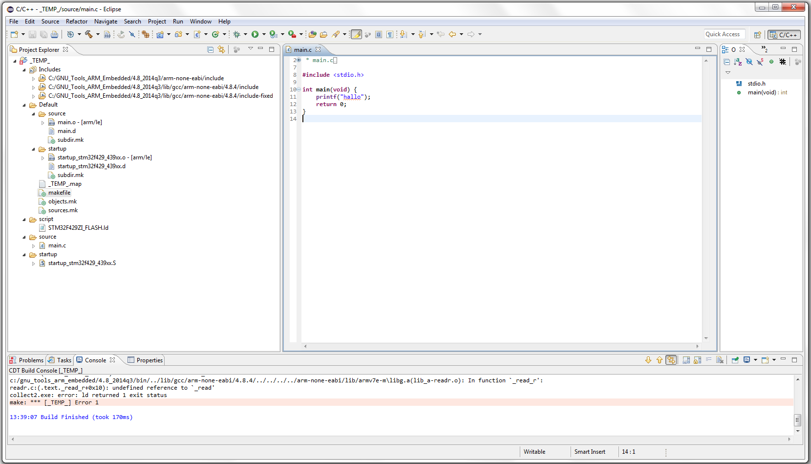

hallo zusammen, ich bin Neueinsteiger in der Embedded-Entwicklung und will den ARM Cortex-M4 auf einem STM32F429 Discovery in C Programmieren. Dazu nutze ich Eclipse Luna für C/C++ Entwickler mit der ARM-Toolchain auf einem Windows 7 Rechner. Beim Linken eines einfachen Makefile-Projekt tritt ein Fehler mit den folgenden Details auf: 13:39:07 **** Incremental Build of configuration Default for project TEMP **** make all 'Building target: _TEMP_' 'Invoking: Cross ARM C Linker' arm-none-eabi-gcc -mcpu=cortex-m4 -mthumb -O0 -Wall -g -Xlinker --gc-sections -Wl,-Map,"_TEMP_.map" -o "_TEMP_" ./startup/startup_stm32f429_439xx.o ./source/main.o c:/gnu_tools_arm_embedded/4.8_2014q3/bin/../lib/gcc/arm-none-eabi/4.8.4/ ../../../../arm-none-eabi/lib/armv7e-m\libg.a(lib_a-exit.o): In function `exit': exit.c:(.text.exit+0x16): undefined reference to `_exit' c:/gnu_tools_arm_embedded/4.8_2014q3/bin/../lib/gcc/arm-none-eabi/4.8.4/ ../../../../arm-none-eabi/lib/armv7e-m\libg.a(lib_a-sbrkr.o): In function `_sbrk_r': sbrkr.c:(.text._sbrk_r+0xc): undefined reference to `_sbrk' c:/gnu_tools_arm_embedded/4.8_2014q3/bin/../lib/gcc/arm-none-eabi/4.8.4/ ../../../../arm-none-eabi/lib/armv7e-m\libg.a(lib_a-writer.o): In function `_write_r': writer.c:(.text._write_r+0x10): undefined reference to `_write' c:/gnu_tools_arm_embedded/4.8_2014q3/bin/../lib/gcc/arm-none-eabi/4.8.4/ ../../../../arm-none-eabi/lib/armv7e-m\libg.a(lib_a-closer.o): In function `_close_r': closer.c:(.text._close_r+0xc): undefined reference to `_close' c:/gnu_tools_arm_embedded/4.8_2014q3/bin/../lib/gcc/arm-none-eabi/4.8.4/ ../../../../arm-none-eabi/lib/armv7e-m\libg.a(lib_a-fstatr.o): In function `_fstat_r': fstatr.c:(.text._fstat_r+0xe): undefined reference to `_fstat' c:/gnu_tools_arm_embedded/4.8_2014q3/bin/../lib/gcc/arm-none-eabi/4.8.4/ ../../../../arm-none-eabi/lib/armv7e-m\libg.a(lib_a-isattyr.o): In function `_isatty_r': isattyr.c:(.text._isatty_r+0xc): undefined reference to `_isatty' c:/gnu_tools_arm_embedded/4.8_2014q3/bin/../lib/gcc/arm-none-eabi/4.8.4/ ../../../../arm-none-eabi/lib/armv7e-m\libg.a(lib_a-lseekr.o): In function `_lseek_r': lseekr.c:(.text._lseek_r+0x10): undefined reference to `_lseek' c:/gnu_tools_arm_embedded/4.8_2014q3/bin/../lib/gcc/arm-none-eabi/4.8.4/ ../../../../arm-none-eabi/lib/armv7e-m\libg.a(lib_a-readr.o): In function `_read_r': readr.c:(.text._read_r+0x10): undefined reference to `_read' collect2.exe: error: ld returned 1 exit status make: *** [_TEMP_] Error 1 13:39:07 Build Finished (took 170ms) Leider gibt es zu der Fehlermeldung bei Google zu viele Anfragen mit verschiedenen Ursachen. Kann mir bitte jemand helfen? Falls noch Informationen benötigt werden - einfach fragen ;) Danke
Diese Funktionen sind die Backends, die von den entsprechenden Funktionen der Standardbibliothek aufgerufen werden. Die musst du selbst mit Leben ausfüllen, denn nur du weißt, woher ein read() bspw. etwas lesen soll. (Disclaimer: allzu tief stecke ich in den ARM-Dingen selbst noch nicht drin, das ist aber, wie ich es verstanden habe.)

Vielen Dank - der erste Beitrag hat mir sehr geholfen. Ich arbeite ohne bestehende libs. Der Linker hat Funktionen gesucht die ich nicht brauche also habe ich (-nostdlib) vor dem Linkeraufruf im makefile gesetzt.
