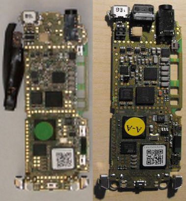

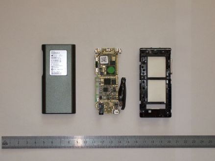

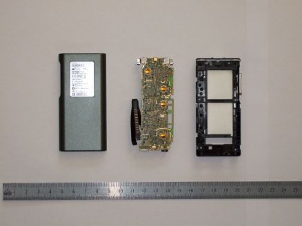

It is really hard to damage the RogerX with normal use, so I am not thinking it is damaged. I rather think that the RogerX output is at a microphone level--basically not registering at the normal DAI port of the Soundgate 3. Another approach could than be to use the telecoil connector. On the middle image you can see the 4 pin connector at the right bottom. Does anyone know what signal strength a telecoil generates? The battery of the Soundgate has a voltage of 3.7V .

Comparing the internal photo's from the FCC reports, I am wondering whether all the hardware isn't already there---that is all except the actual Euro port. In the included photo's the Soundgate2 is on the left side, the StreamerPro on the right. The image resolution is of course abysmal, but at 600% magnification it does allow the check whether the electronic parts are present or not. It seems only the Euro port is missing!! Hopefully the firmware of the Soundgate also has capability to run it. There are 5 soldered connection points for the euro port on the StreamerPro. I would assume that 3 are the basic GRD, V_DD and OUT and 2 are a switch to account for jack present/not present. Does someone know how such a euro port is normally configured?
