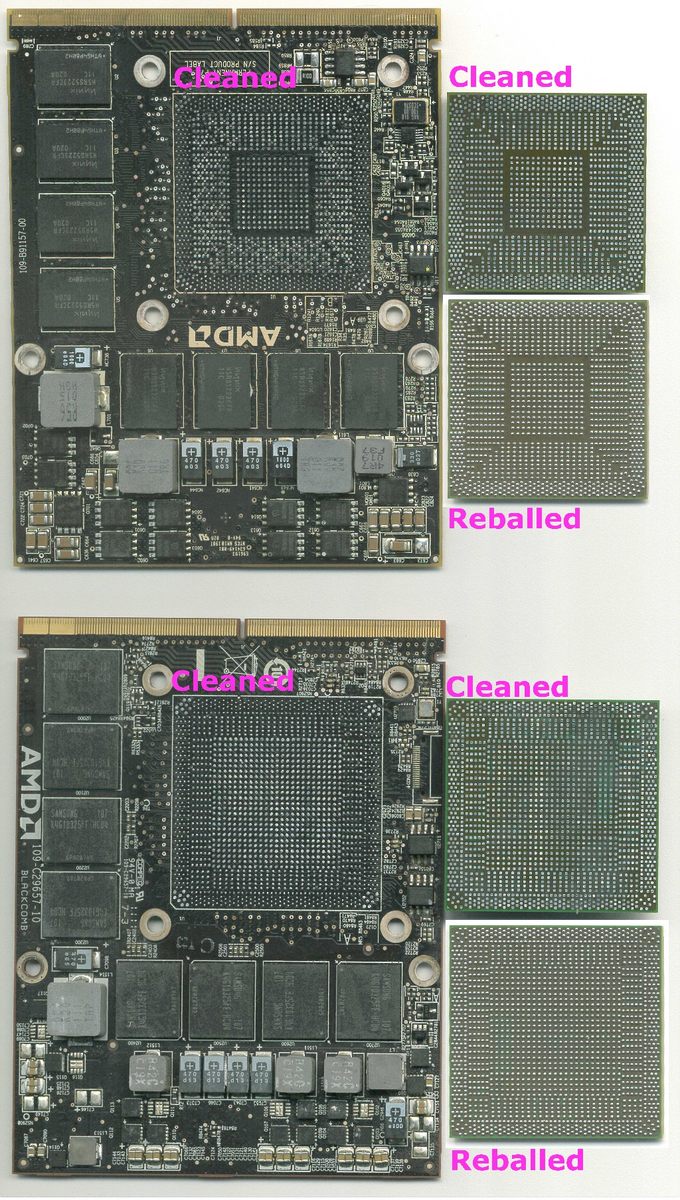

Bin Auslander, verstehe Deutsch. Schaue gelegentlich dieses Forum an.
Schreiben aber ist zu schwierig... Also hoffentlich ist English kein
problem?
IR6500 are cheap IR Rework stations, not professional.
Also watch out which model you get. There are models using only 1 square
800 watt heater in bottom and probably 400-450 on top.
Like the one you describe, would be a bad choice.
Bottom heater is ok for small pcbs maybe but way too low powered for
large ones. Especially on high mass multilayer pcbs.
Other models have 3x 600 watt bottom and a 400-450 watt top. These are
usable but for larger boards an IR Pro using 4x600 watt gives much
better result.
Also, these machines are using cheap Chinese heaters. Might perform
well, or not. If not replacing them with e.g. Elstein elements boosting
performance seriously. Will still be cheaper than buying a
"professional" machine.
They also don't have an optical placement system which can make life
easier with small grid bgas. But it can be done manually.

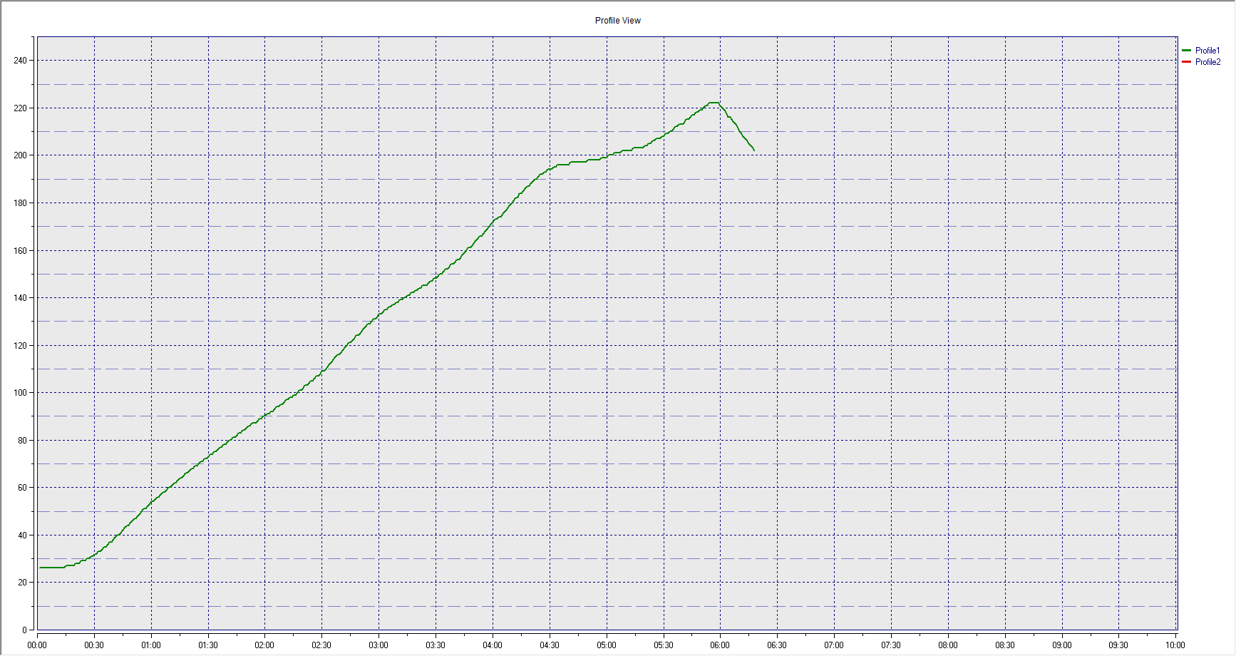

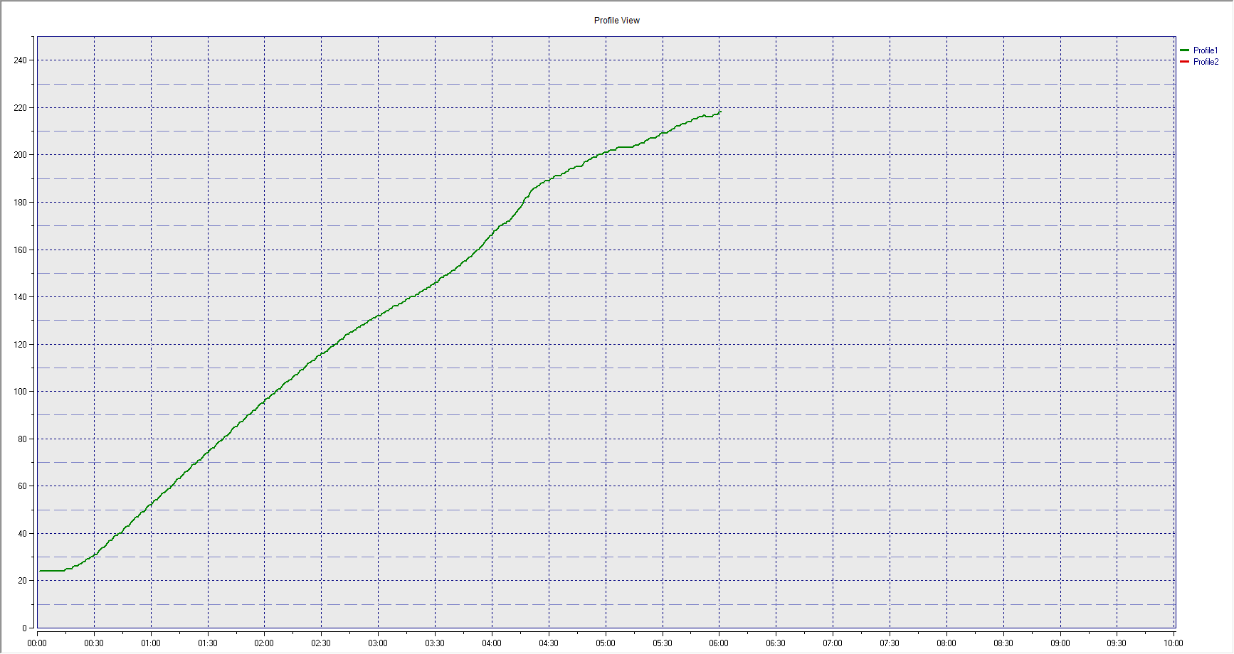

Next thing is they have pretty simple pid controllers. Bottom one is
only a setpoint without profiles, ramp...
On the top controller you can set ramp, dwell and temp. Basic but once
you get how it works more than capable.
The professional machines might give better control and profiles maybe
follow the programmed curve more accurately but the other's simplicity
can be an advantage too.
Like say if a profile ends and still no lift it can start an "emergency"
profile with a higher temp setting. This I can do within a few seconds
so the pcb is still about the same temp.
Once I see solder gets liquid can press a pauze button or let it go up a
few extra degrees to be sure and pause it then, Wait a few seconds,
swing heater sidewards and lift component.
No lift? Swing heater back... Which of course isn't advisable when you
want to reball and use same bga again. But when experimenting and
learning how to use the machine, it helps you to know what temps you
have to set to create profiles.
