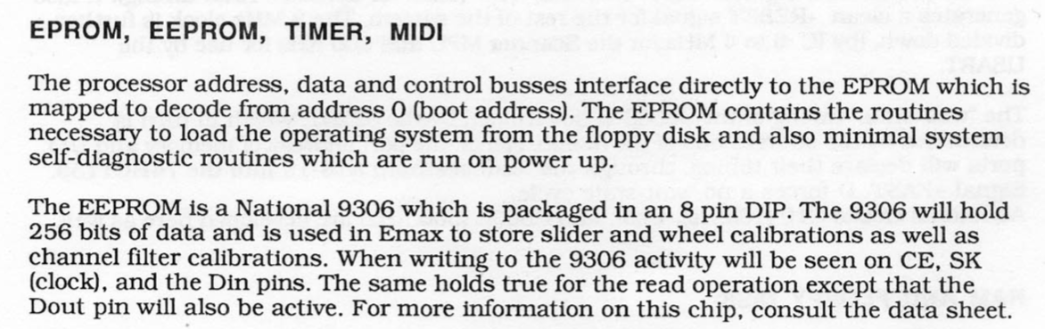

Mit allem Respekt, aber was der Sampler konnte, lässt sich heute in SW realisieren. Das einzige, was man bräuchte, wären die Samples aus den EEPROMs.
Audiomann schrieb: > Mit allem Respekt... > Das einzige, was man bräuchte, wären die Samples aus den > EEPROMs. Mit allem Respekt, bei einem 256Bit EEPROM 9306 der da verbaut ist, können das wohl nicht gar so komplexe Samples sein... :-))

https://nonaudio.wordpress.com/emulatorarchive/emax/technical/ ebenda Support Chips One standard 6850 UART chips provides MIDI and RS422 serial interfacing. The floppy disk gets the usual WD1772 controller. The floppy drive is the most expensive single component in an Emax at $250. Unbelievable ! Hard Disk The optional internal SCSI hard disk requires a SCSI upgrade, which is possible with later versions of the Emax. The drive is a Miniscribe (later Maxtor) 8425S with 20 MB of space. Nabitte alte Bekannte das selbe zeug was Atari benutzte vor der XF551 und weiter dort Circuit Board Versions There are 3 main circuit boards in the Emax, the digital board for the processors, memory and E chip (sometimes this sits on a daughter board), a front panel board for the controls, and an analog output board. The digital and analog board went through three main versions, as the Emax was developed with further hardware features and as bugs were fixed in the electronics.The digital board versions are important as they determine whether a SCSI interface can be added. Version 1 – initial digital board found in just the first few basic Emax’s – it cannot be upgraded to take a Hard Disk or SCSI Version 2 (PC326) – has 24-pin boot ROM, SCSI controller chip socket and can be upgraded to HD/SCSI with modifications. Version 3 (PC333) – already has a SCSI controller socket and 28-pin Boot ROM. Easy to upgarde to external SCSI, especially if the Emax is already a HD model. ....nix hexerei nur Fleiß gefordert loggen, analysieren, interface basteln, manipulieren, checken Namaste
Bearbeitet durch User
