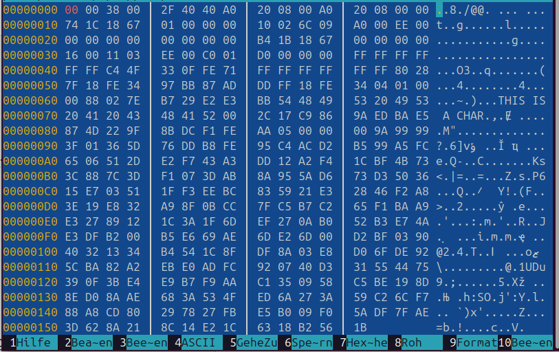

Was mir dann korrekt das ESPNOW Packet empfängt (WLANif im Monitor
mode):
len:349
----------------------------new packet-----------------------------------
0x00, 0x00, 0x38, 0x00, 0x2f, 0x40, 0x40, 0xa0, 0x20, 0x08, 0x00, 0xa0, 0x20, 0x08, 0x00, 0x00,
0x74, 0x1c, 0x18, 0x67, 0x01, 0x00, 0x00, 0x00, 0x10, 0x02, 0x6c, 0x09, 0xa0, 0x00, 0xee, 0x00,
0x00, 0x00, 0x00, 0x00, 0x00, 0x00, 0x00, 0x00, 0xb4, 0x1b, 0x18, 0x67, 0x00, 0x00, 0x00, 0x00,
0x16, 0x00, 0x11, 0x03, 0xee, 0x00, 0xc0, 0x01, 0xd0, 0x00, 0x00, 0x00, 0xff, 0xff, 0xff, 0xff,
0xff, 0xff, 0xc4, 0x4f, 0x33, 0x0f, 0xfe, 0x71, 0xff, 0xff, 0xff, 0xff, 0xff, 0xff, 0x80, 0x28,
0x7f, 0x18, 0xfe, 0x34, 0x97, 0xbb, 0x87, 0xad, 0xdd, 0xff, 0x18, 0xfe, 0x34, 0x04, 0x01, 0x00,
0x00, 0x88, 0x02, 0x7e, 0xb7, 0x29, 0xe2, 0xe3, 0xbb, 0x54, 0x48, 0x49, 0x53, 0x20, 0x49, 0x53,
0x20, 0x41, 0x20, 0x43, 0x48, 0x41, 0x52, 0x00, 0x2c, 0x17, 0xc9, 0x86, 0x9a, 0xed, 0xba, 0xe5,
0x87, 0x4d, 0x22, 0x9f, 0x8b, 0xdc, 0xf1, 0xfe, 0xaa, 0x05, 0x00, 0x00, 0x00, 0x9a, 0x99, 0x99,
0x3f, 0x01, 0x36, 0x5d, 0x76, 0xdd, 0xb8, 0xfe, 0x95, 0xc4, 0xac, 0xd2, 0xb5, 0x99, 0xa5, 0xfc,
0x65, 0x06, 0x51, 0x2d, 0xe2, 0xf7, 0x43, 0xa3, 0xdd, 0x12, 0xa2, 0xf4, 0x1c, 0xbf, 0x4b, 0x73,
0x3c, 0x88, 0x7c, 0x3d, 0xf1, 0x07, 0x3d, 0xab, 0x8a, 0x95, 0x5a, 0xd6, 0x73, 0xd3, 0x50, 0x36,
0x15, 0xe7, 0x03, 0x51, 0x1f, 0xf3, 0xee, 0xbc, 0x83, 0x59, 0x21, 0xe3, 0x28, 0x46, 0xf2, 0xa8,
0x3e, 0x19, 0xe8, 0x32, 0xa9, 0x8f, 0x0b, 0xcc, 0x7f, 0xc5, 0xb7, 0xc2, 0x65, 0xf1, 0xba, 0xa9,
0xe3, 0x27, 0x89, 0x12, 0x1c, 0x3a, 0x1f, 0x6d, 0xef, 0x27, 0x0a, 0xb0, 0x52, 0xb3, 0xe7, 0x4a,
0xe3, 0xdf, 0xb2, 0x00, 0xb5, 0xe6, 0x69, 0xae, 0x6d, 0xe2, 0x6d, 0x00, 0xd2, 0xbf, 0x03, 0x90,
0x40, 0x32, 0x13, 0x34, 0xb4, 0x54, 0x1c, 0x8f, 0xdf, 0x8a, 0x03, 0xe8, 0xd0, 0x6f, 0xde, 0x92,
0x5c, 0xba, 0x82, 0xa2, 0xeb, 0xe0, 0xad, 0xfc, 0x92, 0x07, 0x40, 0xd3, 0x31, 0x55, 0x44, 0x75,
22
0x39, 0x0f, 0x3b, 0xe4, 0xe9, 0xb7, 0xf9, 0xaa, 0xc1, 0x35, 0x09, 0x58, 0xc5, 0xbe, 0x19, 0x8d,
23
0x8e, 0xd0, 0x8a, 0xae, 0x68, 0x3a, 0x53, 0x4f, 0xed, 0x6a, 0x27, 0x3a, 0x59, 0xc2, 0x6c, 0xf7,
24
0x88, 0xa8, 0xcd, 0x80, 0x29, 0x78, 0x27, 0xfb, 0xe5, 0xb0, 0x09, 0xf0, 0x5a, 0xdf, 0x7f, 0xae,
25
0x3d, 0x62, 0x8a, 0x21, 0x8c, 0x14, 0xe2, 0x1c, 0x63, 0x18, 0xb2, 0x56, 0x1b,
Dort finde ich auch folgende Daten wieder:
wifi:mode : sta (c4:4f:33:0f:fe:71)
buf->a, "THIS IS A CHAR");
0x54, 0x48, 0x49, 0x53, 0x20, 0x49, 0x53, 0x20, 0x41, 0x20, 0x43, 0x48,
0x41, 0x52,
Meine Absender MAC und meinen String (strcpy(buf->a, "THIS IS A CHAR")).
Nun bin ich aber leider am Ende.
Wie finde ich in dem HEX-Packet was ich gesendet habe und bekomme es
wieder Sinvoll zusammen?

von Christoph M. (mchris)
In Deinem Beispiel steht der Text wohl ab Adresse 0x69.
von Welle 🧐 S. (w3llschmidt)
Danke Christoph!
Ok mit festen Adressen könnte man arbeiten.
Aber den Rest finde ich nicht :(
    strcpy(buf->a, "THIS IS A CHAR");
    buf->b = 5;
    buf->c = 1.2;
    buf->d = true;
Beitrag #7811230 wurde vom Autor gelöscht.
Ich bin mir nicht sicher, ob die Adresse immer gleich ist. Eine mögliche
Lösung wäre, die Daten am  mit einer Magic-Number zu versehen und diese
im Empfangsframe zu suchen.
int b=5 liegt bei Adresse 0x89
und float c=1.2 (9A 99 99 3F) liegt bei 0x8D

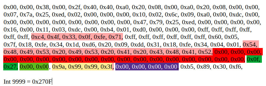

Sieht gut aus, die Positionen scheinen fest.
Erst kommen 16 byte für den String und dann je 2byte für INT,FLOAT,BOOL.
Ganz oben die MAC vom ESP32.
// Structure example to send data
// Must match the receiver structure
typedef struct struct_message
  char a[32];
  int b;
  float c;
  bool d;
} struct_message;
Warum die Werte INT,FLOAT,BOOL Rückwärts im Buffer stehen, keine Ahnung.

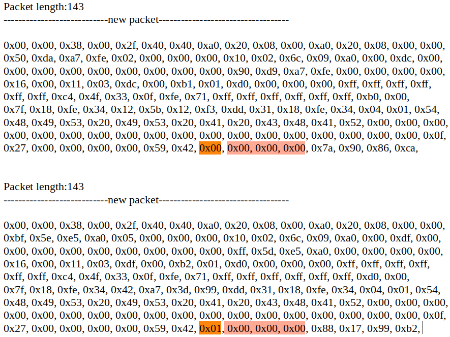

Hier habe ich nochmal bool: false und true gesendet.
Welle 🧐 S. schrieb:
> Erst kommen 32 byte für den String (...)
von J. S. (jojos)
Passt doch, xtensa (und auch X86 und Cortex-M) hat little endianness.

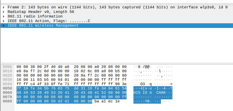

Danke für den Anstoss mit Wireshark, ich habe vorher die ganze Zeit
gehirnt warum mein Packet nicht wie das bei Espressif beschrieben
aussieht :)
Das ganze Radiotap Geraffel hatte ich verdrängt.
